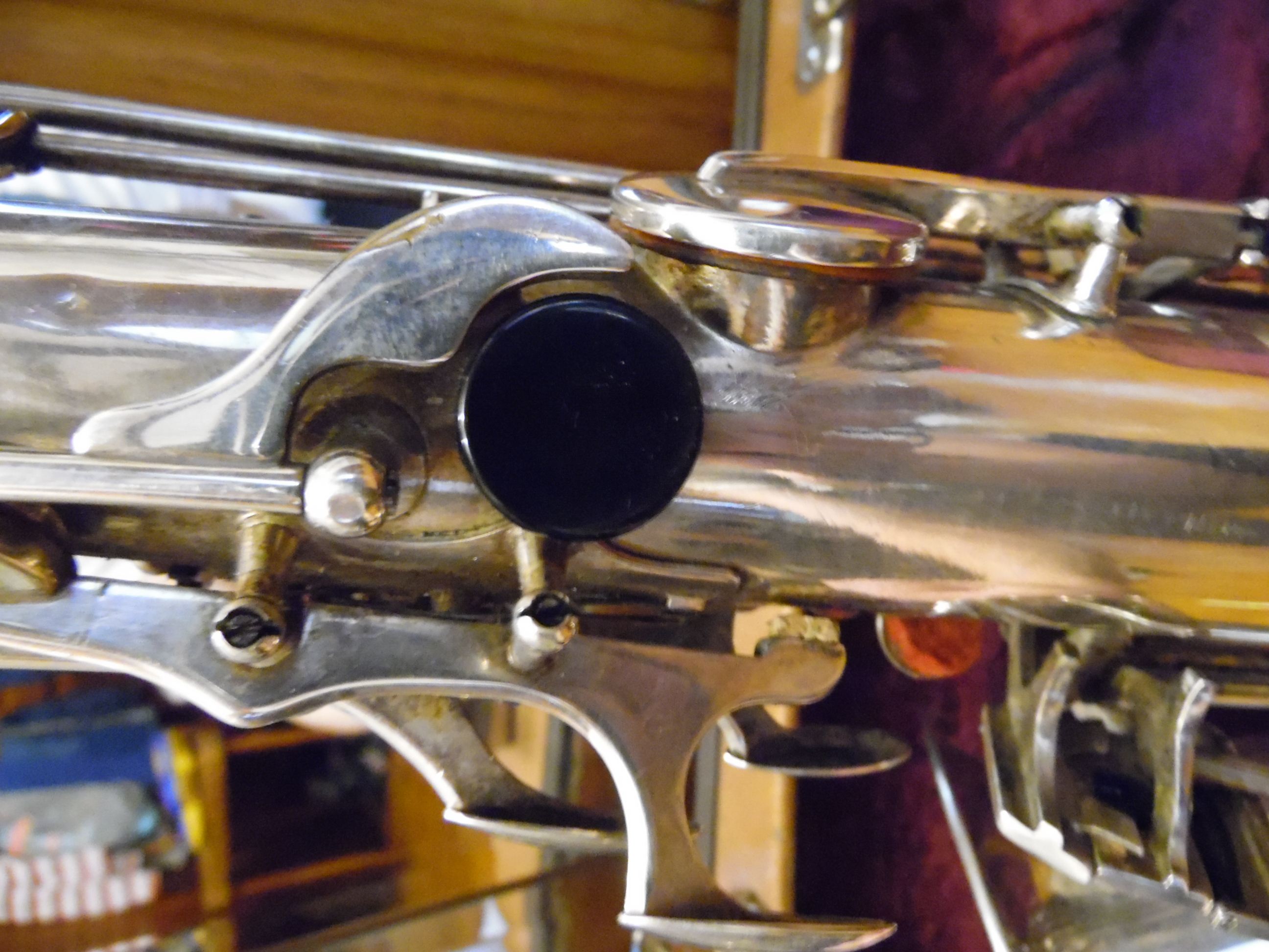

Hello,
There are two tenor-models of B&S "Blue Label". This miracle can just be solved by getting some pictures.
Please a clear photo from the right side. And one from the thumb rest.
Thanks,
Thanks,
Yes, this is enough. Thank you.
Your Tenor is from the first B&S model line.
#4427 was built in 1977.
Regards, Tobi.
Regards, Tobi.
