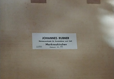

A japanese instrument maker has a Johannes Rubner bass from 1988. He sent me the label.
rubner 88.jpg (54.36 KiB) 15321 mal betrachtet
Does it mean that the Rubner munfacture made basses for Musima at that time and others as Johannes Rubner instruments?
Still questioning the difference of quality.
Thanks,
Daniel
